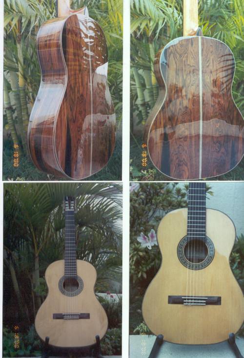

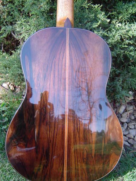

Here are a couple of pics that I hope can illustrate the completed finish
Good luck guys!
